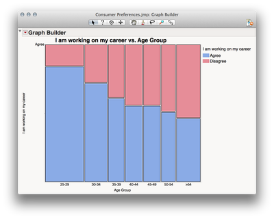

Hi Smoore2,
Using graph builder you can create a mosaic plot with either proportionally sized or equally sized x categories.
If you use your X variable in the X drop zone, you will produce the typical mosaic plot with proportionally sized categories on the X

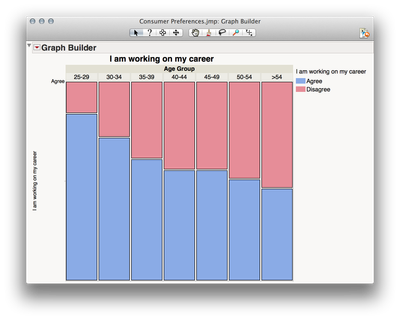

But, if you use your X variable in the "Group X" drop zone at the top, JMP will size the categories equally.
If you right click the category labels on the top, then select "X Group Edge" you can move the labels to the bottom (to most closely resemble the original mosaic plot).

Hi Smoore2,

Steven_Moore
Level VI
Re: Mosaic Plots Question
Thank-you, Julian!

winfriedkoch0
Level IV
This is a good solution for the simple situation as discussed.
If I want to generate a plot combining several variables, then I usually must put one variable in the X drop zone and then the proportional sizing is no longer available for this variable.
By the way, I usually am not free to select which variable is dropped in the x-zone because of the fixed priorization of x and Group x drop zones in the set-up of the plot.
