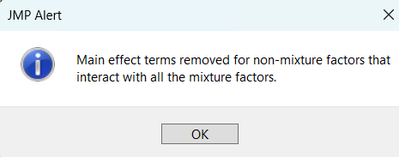

Concerning the model, you may expect some redundancies when specifying terms depending on the assumed model. For example, as sum of mixture factors is equal to 1, main effects for non-mixture factors and interactions between non-mixture factors and mixture factors can't be present independently in the design as they are aliased (but JMP will inform you and deleted these terms if you have these redundancies):
