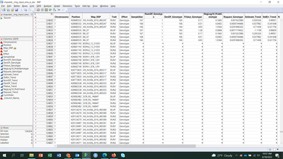

I'm trying to run my GWAS analysis. When obtaining the results in chromosome 7, some missing values appear. I don't understand why it appears this way. Can someone help me?

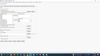

Thank you for the quick reply. I'm using JMP Genomics 13.2. I ran the analysis through workflows > advanced > Genetic Q-K analysis workflow.
Let me know if that information helps.
Re: Missing values gwas analysis
Thanks for the information.  I that version number refers to the version of JMP that JMP Genomics is using. Did you get the number from the Help>About JMP option?

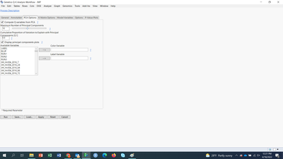

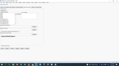

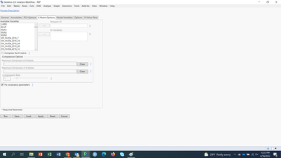

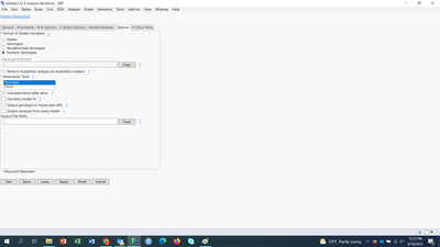

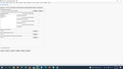

I am not sure why that workflow is giving missing values for your data set. It could be a few things like not enough non-missing genotype data for those SNPs (even though the annotation exists) or some other reason like missing values for Q or K information for those SNPs. Is it possible to share which settings you used for that workflow? Screenshots are good for each tab.

I'm sorry, the version of JMP Genomics is 9.1.
SuperEla_0-1650302697697.pngSuperEla_0-1650302697697.pngSuperEla_1-1650302713025.pngSuperEla_1-1650302713025.pngSuperEla_2-1650302730125.pngSuperEla_2-1650302730125.pngSuperEla_3-1650302745008.pngSuperEla_3-1650302745008.pngSuperEla_4-1650302752527.pngSuperEla_4-1650302752527.pngSuperEla_5-1650302759531.pngSuperEla_5-1650302759531.png
Thanks, that helps a lot. Let me check and get back to you to see if I can find a reason why before you contact support

OK, I checked a data set I have with a few continuous traits and numeric genotypes. All of my SNP have some sort of result.  It is not clear to me why yours show missing values. I have seen where some SNPs are excluded and do not have values, but there would be a column that would let you know which ones were excluded and I do not readily see that column in your results table.
I think now is a good time to contact [email protected]. Sorry I could not figure this one out for you.
