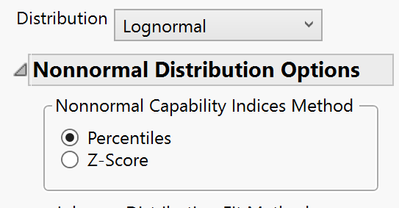

JMP has two places where you can perform process capability. The Distribution platform and the Process Capability platform (under Analyze>Quality and Process).
You've used the distribution platform, which is the platform that I prefer to use.  However, the Process Capability platform provides additional options for computing capability indices for non-normal distributions (note to self: this seems to be true also for v15 of JMP which has had process capability overhauled in the distribution platform.
The key point is this.  In the Process Capability platform you can two different types of calculation:
Switching to Z-score gives the same result as Minitab.
This hopefully explains the difference - although begs the bigger question of which method to use (coincidentally I am currently investigating this same question but as of yet I'm not in a position to express an opinion - having said that, if you transform the data the result for this data is comparable to the Z-score result).

I followed your suggestion also for other type of distribution (like Weibull).
There is a difference if I use Percentiles or Z-score (and with Z-score the results matchs with Minitab).
This is good... for the understanding: step 1.
Now coud be usefull to understand the differences of CPK resutls... according the difference in the "Capability Index Method": as you can image... in front of a discussion (with a customer or supplier)... this can create long long additional discussions.

You can find the documentation about the two different methods for calculating nonnormal capability indices here.  I hope that helps some.  Also, starting with JMP 15, both of these methods for calculating nonnormal capability are available in the distribution platform as well for nonnormal distribution fits.
