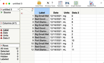

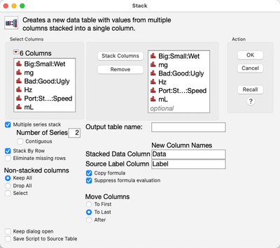

Interactively this is easy to do with a Multiple series stack.
Use Tables->Stack and add all the columns to the Stack Columns list. Then click the checkbox for Multiple series stack. Set Number of Series to 2 and don't check Contiguous.
You'll get a table like this:
Rename the Data column to Date and the Label 2 column to Units.

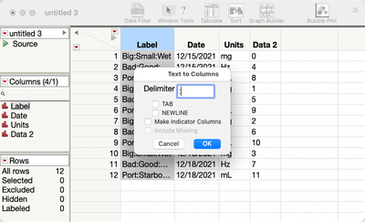

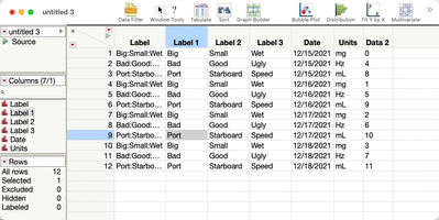

Then, you can use Cols->Utilities->Text to Cols... to split the Label column into three columns using a colon (":") as the delimiter.
You'll get this:
