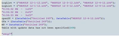

I understand I need to keep the tables that were added to the list open - if I comment out the Close All(Data Tables, nosave) in my code I get
the following in my Log (I have a reference to an origianl table that shouldn't be in the openDT list, and that transfers into the OTs.  I'm sure I just need a close fxn for that table and I could figure that out.  I've specified previously the merge does work, but not how I want it to work.
But in my code where I have //invisible (for the w = z << Split...), I want to uncomment the invisible, but because the invisible fxn only recognizes the last table of the loop and all others are deleted I need a way to references these and keep them in a list so I can refer to them as a whole. (Close all is also commented out)  How do I do this?
Invisibility is the problem, b/c unless I figure out a way to reference each invisible table then there's no way I can merge multiple tables. It's looking like I'll need to move the Join code into the loop, but I don't know how to incorporate this if it's only looping through one table at a time and I'm needing to reference at least two.
