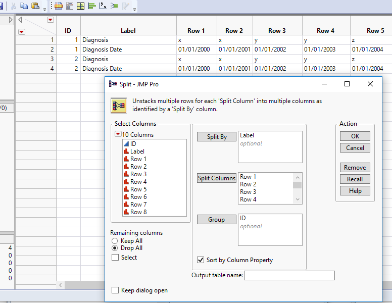

You can use the table split:
Tables > Split
Then Split By = Label
Split Coumns = Rows
Group = ID
I like to click the "Keep dialog open" option as it often takes a couple of rounds to get things just right.

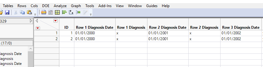

You can do this by using the Split Platform
     Tables==>Split
Which creates the following output data table

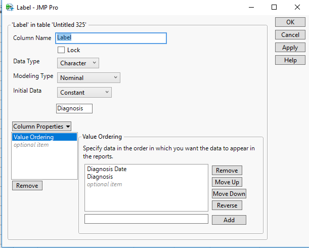

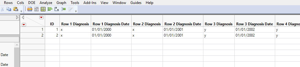

The order of the rows is based upon the alphabetical order of the Label column.  So if you want to change that you can use the Value Ordering Column Property to change the order
And then the final data table will look like:
Tables > Split
Split Coumns = Rows
Group = ID
     Tables==>Split
