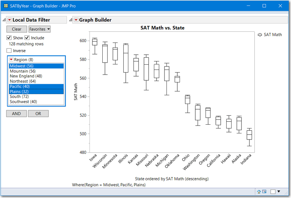

If you are using Graph Builder to draw your boxplots, you can right click in the X-Axis (group axis) and select which Order by Statistic, default is the mean, and Select which Y variable to order by either ascending or desending.
The script below opens the JMP sample data table SATByYear.jmp and creates a Graph Builder boxplot of SAT Math vs. State with a Local Data Filter for Region.  Now select one or several regions and ordering is updated automatically. Change from descending to ascending.  You can do all of this voa point & click.
I hope this meets your needs.
