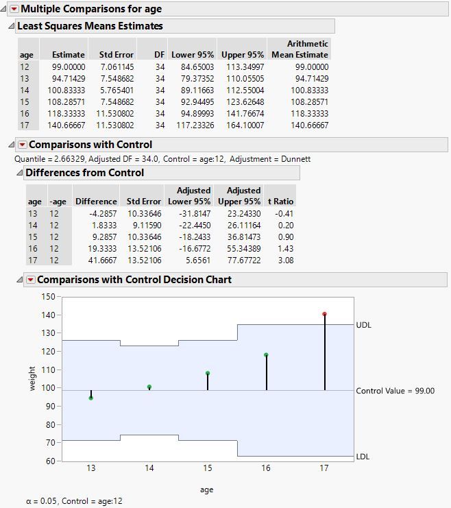

Select Analyze > Fit Model. Enter your response as Y and your predictor with Add (Effects) and click Run. Click the red triangle at the top left and select Estimates > Multiple Comparisons, select Comparisons with Control - Dunnett, and then click OK. Select your control level and click OK. You will get a table like this:
Can you use the differences here for your purpose? Note that you can right-click on the table and select Make Into Data Table. You can now use column formulas to compute values or visualize the table with Graph Builder.
