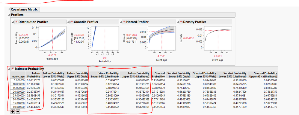

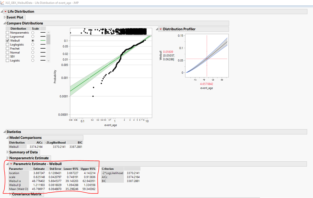

1. Save specific report data from distribution (see the data tables in red)Capturesss.PNGCapture.PNG

cr=current report();
weibulltable=cr<< XPath( "//OutlineBox[text() = '"||"Parametric Estimate - Weibull"|| "']" );
//grab the first instance of the table and 'make combined' if other results are needed
weibulltable=cr<<XPath("//OutlineBox[text()='Statistics']//OutlineBox[text()='Parametric Estimate - Weibull']//NumberColBox[NumberColBoxHeader[text()='Estimate']]");
weibulldt=weibulltable[1]<<make combined data table;
estimate_prob_table=cr<< XPath("//OutlineBox[text()='Statistics']//OutlineBox[text()='Parametric Estimate - Weibull']//OutlineBox[text()='Estimate Probability']//NumberColEditBox[NumberColEditBoxHeader[text()='event_age']]");
estimatedt=estimate_prob_table[1]<<make combined data table;
//column selections are different between v18 and 19, the script below would work on yours, 19 is different
estimatedt<<clear column selection;
estimatedt<<select columns("event_age", "Failure Probability", "Failure Probability Upper 95% (Likelihood)", "Failure Probability Upper 95% (Likelihood)")//select columns you need to delete
estimatedt<<invert column selection;
estimatedt<<delete columns();
