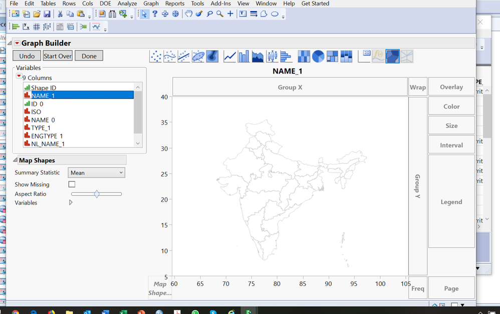

Hi @analyticsmurali ,
Try to put these two files in C:\Program Files\SAS\JMP\14\Maps
or where JMP Maps file is located in your computer.
once you do that, any data file you have with a column that is the list of states will show up on the map.
you can check it all works by opening the NAME file and in the graph builder dragging the Name column to Map Shape. as in the picture.
Let us know if this is what you are looking for

Re: Is there a Name and shape file for country INDIA (including its states) so that we can create Geo map using data for India
ron
Dear Ron
Thanks a ton for your rocket speed response. This solution works perfect.
i was trying to plot Literacy rates of different states and it helped me.
again thanks a lot
regards
Murali
