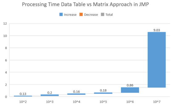

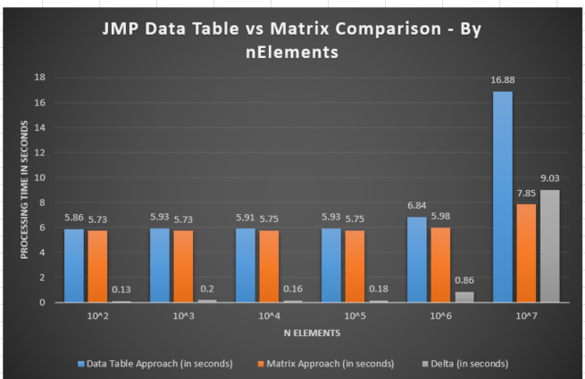

      Thank you for your detailed response. Your interpretation is mostly accurate and I wish I provided more clarity to begin with. I agree and share your preferences between data tables and matrices, would use data tables if I needed more built in methods vs matrices. However, the question I wanted to pick the communities brain on was the speed of handling large data and if and why does the behavior change as the data size increases. I would like to believe it is because of the storage compression that you are referring to.
    One interesting aspect is the amount of time that is saved via data table sub-scripting. At a = 7, it was shaving a good 7 seconds w.r.t to the traditional column formula approach - with matrices still leading in terms of performance.
Best
