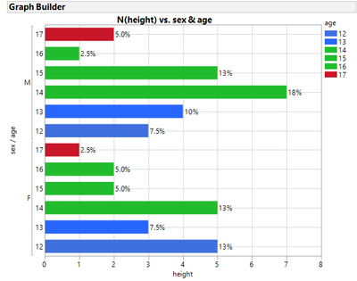

  • If possible, create a graph to represent the table. If it is complex, this is likely not feasible. Below is a simple example. The Graph Builder label is Percent of Total. Note that the bar colors are custom: 12-13 Blue, 14-16 Green, 17+ Red.

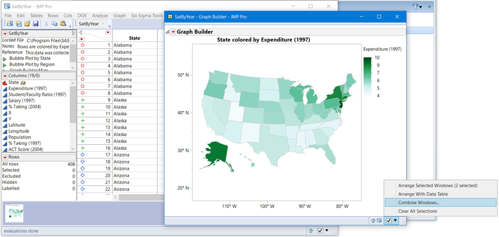

I now need to display this table along with the graph.(I was doing this with tabulate earlier)
Is there an easy way to do this? Sorry new to jmp and have lot of questions.
gzmorgan0
Super User (Alumni)
Re: Color Cells based on formula result and display using tabulate.
You can do this with combine windows.  On the bottom right of your table view border check the box. Do the same for your graph. On the graph select the Menu icon and select Combine Windows.  See screenshot below. A pop-up menu will appear, give it a name and the window has both table and graph.
