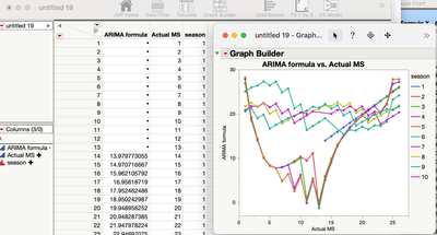

Good news, the JSL you posted is the model.
Not sure how you got JMP to make it for you, but it looks a lot like a prediction formula
I pasted your formula into a column formula, made a second column that repeats 1-26, and gave it the name "Actual MS".
You probably have a data table with 120 rows or more and this formula along with the data you're modeling.
All you have to do is add more rows, insert some data and the prediction formula already in the table will calculate your forecasted results.
