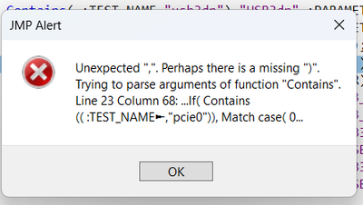

I have added it to my script but received error
can you check what I should change in my script?
Column(dt, "PARAMETR") << Set Each Value( If( Contains(( :TEST_NAME,"pcie0")), Match case( 0 ),"PCIE0",:PARAMETR));

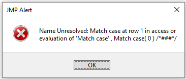

Re: Match case ( 0 )
Column(dt, "PARAMETR") << Set Each Value( If( Contains( :TEST_NAME,"pcie0", Match case( 0 )),"PCIE0",:PARAMETR));
no:
