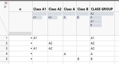

This solution looks complicated but the idea is: get list of all class columns and then use data table subscripting WITH that list and get maximum index of found values (so this assumes that the columns are ordered)

dt << New Column("CLASS GROUP", Character, Nominal, << Set Each Value(
	valcol = Max(Loc(Matrix(!IsMissing(dt[Row(), class_cols])))) + 1;
	dt[Row(), valcol];
