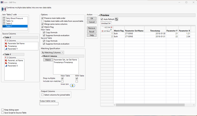

Here are some visuals to support @jthi and @hogi suggestions
Issue 1
     Tables=>Join                Joining Table 2 to Table 1

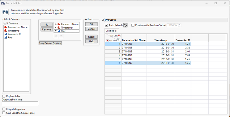

Issue 2
     Tables=>Sort                Create a Virtual Column and call it Row.......the formula for the column is Row()
Then
     Tables=>Join                             Join Table 1 to Table 2
Here is the JSL that will run the 2 issues
names default to here(1);

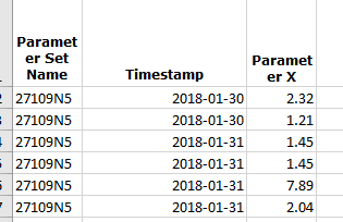

dt1 = New Table( "Table 1",
	Add Rows( 6 ),
	New Column( "Parameter Set Name",
		Character,
		Set Values(
			{"27109N5", "27109N5", "27109N5", "27109N5", "27109N5", "27109N5"}
	New Column( "Timestamp",
		Format( "yyyy-mm-dd", 12 ),
		Input Format( "yyyy-mm-dd" ),
		Set Values(
			[3600115200, 3600115200, 3600201600, 3600201600, 3600201600, 3600201600]
	New Column( "Parameter X",
		Set Values( [2.32, 1.21, 1.45, 1.45, 7.89, 2.04] )

// Join data tables
// → Data Table( "One to Many" )
Data Table( "Table 1" ) << Join(
	With( Data Table( "Table 2" ) ),
	Merge Same Name Columns,
	By Matching Columns(
		:Parameter Set Name = :Parameter Set Name, :Timestamp = :Timestamp
	Drop multiples( 0, 0 ),
	Include Nonmatches( 0, 0 ),
	Preserve main table order( 1 ),
	Output Table( "One to Many" )
// Create the Many to One table
// Sort data table
Data Table( "Table 1" ) << Sort(
	By(
		:Timestamp,
		Transform Column( "Row", Formula( Row() ) )
	Replace Table,
	Order( Ascending, Ascending, Descending )
// Join Table 1 to Table 2
// Join data tables
// → Data Table( "Many to One" )
Data Table( "Table 2" ) << Join(
	With( Data Table( "Table 1" ) ),
	Drop multiples( 1, 1 ),
	Output Table( "Many to One" )
