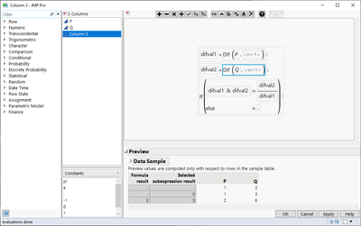

You can calculate difference between rows using Dif() or Lag().
Names Default To Here(1);
dt = New Table("Untitled 2",
	Add Rows(3),
	Compress File When Saved(1),
	New Column("P", Numeric, "Continuous", Format("Best", 12), Set Values([1, 1, 2])),
	New Column("Q", Numeric, "Continuous", Format("Best", 12), Set Values([3, 3, 6]))
dt << New Column("", Numeric, Continuous, Formula(
	difval1 = Dif(:P);
	difval2 = Dif(:Q);
	If(difval1 & difval2,
		difval2 / difval1;
You can explore subexpression values from formula editor if needed
-Jarmo

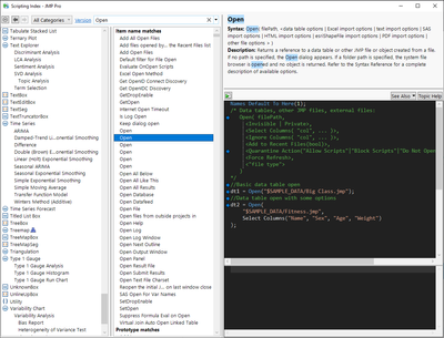

You can. How you should do it, depends where you get the data table. If you open it from somewhere using Open() is the way to go (see Scripting Index (fround from JMP Help menu) and Scripting Guide for more information regarding scripting).
-Jarmo

Also you can directly create the formula to your data table, no need to use script editor
	difval1 = Dif(:P);
	difval2 = Dif(:Q);
		difval2 / difval1;
-Jarmo
