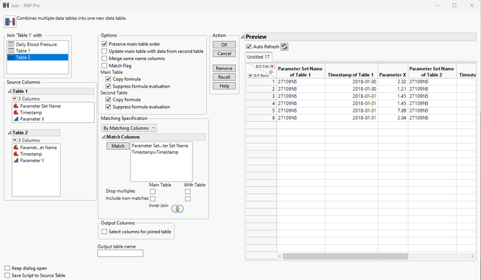

Here are some visuals to support @jthi and @hogi suggestions
Issue 1
     Tables=>Join                Joining Table 2 to Table 1
Issue 2
     Tables=>Sort                Create a Virtual Column and call it Row.......the formula for the column is Row()
Then
     Tables=>Join                             Join Table 1 to Table 2
