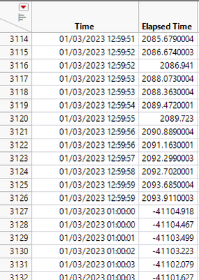

Hi I am struggling to convert a Timestamp into numeric format. I basically want to use the timestamp to create an Elapsed Time column. I am having difficultly achieving this with JMP16. Below is an example of the format. The change from 12:59 to 01:00 also seems to cause issues for me.
I was able to work with excel and manipulate the data to give me an Elapsed time in minutes (from row 1 as starting point). But I would prefer to use JMP and to create a script for it.

Thanks for quick reply and helping with the format. I ran your script and also created and elapsed time column which is basically the following formula..
This gives me the elapsed time in seconds. However I have this issue when the timestamp moves from 12:59pm to 1pm. It is not picking up the AM/PM information. Therefore it thinks it is 01:00AM in error.

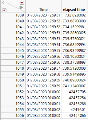

corkman1987
Level II
Re: Manipulating Timestamp
I am still seeing the issue with the sample file i sent you. for example row 1052 onwards. I am using JMP 16 and Windows 10 OS.

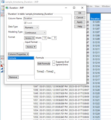

I did the following in JMP 17 on MS win with the formula provided.
It worked on JMP16.2 on MS Win too.
Formulas are in the columns.

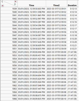

corkman1987
Level II
Hi, thanks for sending this on to me. When i opened it all looked good. However i went into Time 2 and reapplied your formula and the results changed to what i had been seeing before. See below. The 13:00hrs data is changed to 01:00hrs.
I found the source of the issue. My PC settings are on United Kingdom Date and Time. When I restarted JMP after changing to US date and time settings - the formula is worked correct for me.
The formula will not work when my PC time is set for UK.
At least I know where the issue is coming from now. But still don't have a resolution unless I keep my PC settings on US.
