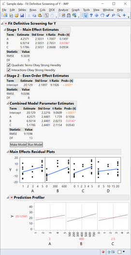

Based on domain knowledge, I would have expected a quadratic effect for factor B which looks like a plateau, with the low level being significantly worse than the mid/high levels, which should be relatively similar. When I look at the results of the 'Fit DSD' algorithm, the main effects residual plot for factor B does in fact look like this. However, the fit DSD algorithm does not output any quadratic effects. I have tried altering the Stage 2 ratio from 1 to 0.1 and found no difference.

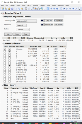

When I take the same dataset and use forward model selection with minimum AICC, I get the following model, which does include B^2 as a term.

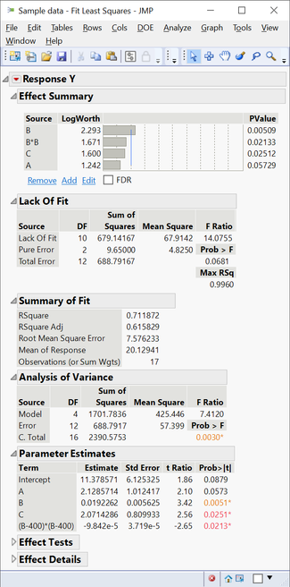

Finally, when actually running the models made by Fit DSD vs. stepwise, I find that the overall p-value and adjusted R^2 of the stepwise-derived model to indicate superior fit (p = 0.0144 and r^2 = 0.438 for fit DSD, p = 0.0030 and r^2 = 0.615 for stepwise)
I repeated this for some other output parameters and found that in general, fit DSD is much more conservative than stepwise selection with regards to second-order terms. Is this true? If so, is it still recommended to use the model from fit DSD, even though it results in poorer model fit?

The "Fit Definitive Screening Design" is an analysis designed for DSD, as it emphasizes and supports the DOE principles of effect hierarchy, effect heredity, and effect sparsity : Principles and Guidelines for Experimental Design (jmp.com)
  • In a first round, the Fit DSD platform tries to find the significant main effects, and create a model based on the identified main effects.
  • In the second round, the residuals from the first model are analyzed to find and detect 2nd order terms (dependent from the main effects identified before, following the principle of effect heredity) like interaction terms or power terms.
By default the platform uses "strong heredity" principle (example: interaction A*B may only be analyzed and identified in the second round if both main effects A AND B are identified and significant in the first round), but you can have more "flexibility" in the modeling by de-checking the "Quadratic terms obey strong heredity" and "Interactions obey strong heredity". That will enable weak heredity, meaning that interaction A*B may be analyzed in the second round if main effect A OR main effect B is identified and significant in the first round for example. In your case, the weak Heredity does provide the same model. More infos here : Effective Model Selection for DSDs (jmp.com)
Please also note that DSD, even if powerful and interesting to detect 2nd order effects, are still screening designs, so you won't be able to detect and estimates all the possible effects, and the power related to quadratic terms or interactions terms is quite low compared to main effects for example, so it seems "normal" to have more difficulty in detecting quadratic effects :
If you think there might still be hidden terms that were not detected among the 2nd order effects, I would highly recommend you to augment your design with more runs (with the platform "Augment Design"), to have more confidence in your model (and possibly detect new quadratic effects and/or interaction effects).
