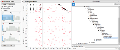

Given a list of values I want to write these to the limits of a local data filter. Here is a (almost) working example (remove data filter and re-add based on building the data filter expression dynamically) but it feels to complicated, is this the best way to do it? (It has to work dynamically for other tables with different number of columns as well)

For limits you could parse the where clause or maybe access the DFIntMinMaxBox and NumberEditBoxes inside it (I would try to parse Where clause). There might also be other methods for this (Show Properties(f) might have some ideas).

And yes for the button I will probably use xpath to extract all the numbereditboxes and from the order I can infer their meaning. I just wanted to make sure you couldn't directly querry the local data filter to tell you the limits.
