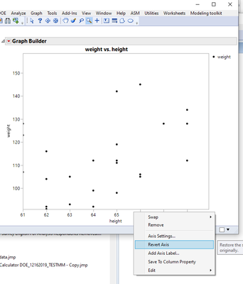

Hi All
Thanks for the suggestion to use Revert axis. At least following is working for me
Names Default To Here(1);
New Window("Big Class Graph",
	V List Box(
		bn = Button Box( "Reset zoom",
			rgp = gb << report;
			axisbox_x = rgp[axis box( 1 )];
			axisbox_y = rgp[axis box( 2 )];
			axisbox_x << Revert Axis;
			axisbox_y << Revert Axis;
		gb = dt << Graph Builder(
			Show Control Panel( 0 ),
			Variables( X( :height ), Y( :weight ) ),
			Elements( Points( X, Y, Legend( 1 ) ) ),
			SendToReport(
				Dispatch(
					"height",
					ScaleBox,
					{Min( 50 ), Max( 75 ), Inc( 5 ), Minor Ticks( 1 )}
				Dispatch(
					"weight",
					ScaleBox,
					{Min( 60 ), Max( 180 ), Inc( 10 ), Minor Ticks( 1 )}

You can revert the axis (also after filtering). Do it once for the X axis and once for the Y axis. You could also program this under your button but it is not that much faster.
