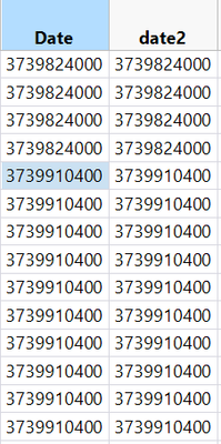

Making exact clone of a column
HI JMP users,
am looking for your help to make identical clone of a column through JMP scipt.
I don't want to select the "Date" column to make a identical column instead script should be able to recognize "Date" column and make a clone column.
Regards

This should create a new column with a different name. Modify this example as necessary for your purpose.
Names Default to Here( 1 );
expr = :weight << Get Script;
Eval(
	Parse(
		Substitute(
			"dt << " || Char( Name Expr( expr ) ),
			"weight",
			"weight 2"

jthi
Re: Making exact clone of a column
By "exact" clone do you mean to copy all formatting, column properties and values?
-Jarmo
Eval(
	Parse(
		Substitute(
			"weight",
			"weight 2"
