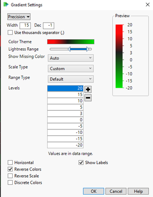

You could create custom scale:
or modify the Number of Labels you have with linear with correct min, center and max values:

Hi jthi,
I was wondering what version of JMP you are using? When I go to gradient settings -> precision, I do not have the "levels" option nor the "show missing colors" option. Is there something I need to press to get those options/categories? I am using JMP pro 15.
Re: Making a heat map- how to customize the interval of the legend?
Hi @ClusteredMining
Those options are in JMP 16. See my post below for the options in JMP Pro 15.

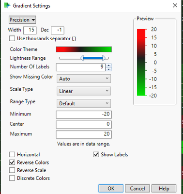

Hi @ClusteredMining ,
There is a way. But first, which version of JMP are you using? You can try right clicking on the gradient in the legend itself and then choose "Gradient...". Options will appear:
Set your min to be -20, center to be 0 and Max to be 20. Then choose number of labels to be 9 (you have 9 levels). Then click on OK.
That should get you what you want.
This was done in JMP 15 and 16. If you have an earlier version, give it a try to see if those options exist.
