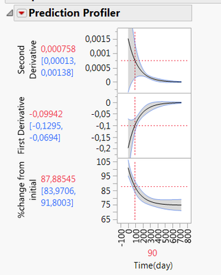

Dear all,
One of my friend doesnt have jmp. I prepared an excel for it. But I just calculate prediction value from equation. I do not calculate 95% upper lower prediction of model in excel. Could you please inform how can i calculate 95%range of prediction model in excel. I used nonlinear part of jmp.
Thanks anyone help to solve this issue.

Hello @nac ,
If I understand you correctly your goal is to take the model you created in JMP and score it in Excel.  If so you should be able to save the formula for the confidence limits directly from the nonlinear platform and then recreate the column formulas just like you did for the prediction.
