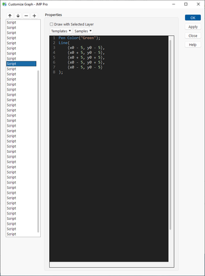

Hello, I've been struggling trying to make something like the Drag & Drop interfaces used in (JMP Pro) SEM and Reliability Block Diagrams.
The idea is to have a pallet of "boxes" down the left side of the screen.  I want to grab one of the boxes, drag it into the center area of the screen, drop it, then go grab another box, drag & drop, etc.
I've tried several ways, including handles and mousetraps.  I can get part of the way, but not all the way.
My latest code is shown below, using Mousetrap.  I can grab the box in the upper left of the GraphBox, and drag it around the screen, and drop it where I want it.  (It turns black when it is dropped.)  But then I can't go grab another box.  I can only move the box I just dropped.  I cannot add another box.
I'm currently building this as an Application, but happy to change that if it helps.
Script below shows what I've coded in Application Builder.  Attached file contains the entire application.
I fear there are aspects of Mousetrap and GraphBoxes and Add Graphics Scripts that I just don't grasp.  Can anyone help?

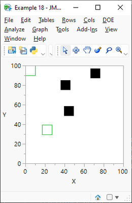

jthi
Re: Making a drag & drop script
You most likely do not want to keep adding new graphic scripts all the time as it will end up overwriting your If() and "flood" the framebox
You can build this in much better way, but below is one example what you could possibly do
Names Default To Here(1);
rects = {};
x0 = 5;
y0 = 95;
x = .;
y = .;
nw = New Window("Example",
	Graph Box(
		Frame Size(200, 200),
		Mousetrap(
			x0 = x;
			y0 = y;
		p = EvalExpr(Polygon(
			{Expr(x0+5), Expr(y0-5)},
			{Expr(x0+5), Expr(y0+5)},
			{Expr(x0-5), Expr(y0+5)},
			{Expr(x0-5), Expr(y0-5)}
		Insert Into(rects, Name Expr(p));
		Pen color("Green");
		Line({0,90}, {10,90},{10,100}, {0,100},{0,90});
		If(x >= x0 - 5 & y >= y0 - 5 & x <= x0 + 5 & y <= y0 + 5,
			Pen color("Green");
			Line({x0-5, y0-5}, {x0+5, y0-5}, {x0+5, y0+5}, {x0-5, y0+5}, {x0-5, y0-5});
		For(i = 1, i <= N Items(rects), i++,
			Pen Color("Black");
			Eval(rects[i]);
Edit: Added initialization for x and y
-Jarmo

hogi
Level XIII
 I get:
DisplayBox[EvalContextBox]
Name Unresolved: x in access or evaluation of 'x' , x/*###*/
at line 26
do x&y  persist outside the mousetrap?
edit:
They "persist outside of the Mousetrap"
- but not forever. It seems they are reset when the mouse button is released:
https://community.jmp.com/t5/Discussions/Can-JMP-graphics-have-this-effect/m-p/921213/highlight/true...
Cool, with the green rectangle, the illusion of "dragging" is very convincing ; )
Without the green rectangle, it feels much more like: add a black rectangle with every mouse click.
(view in My Videos)
jthi
I most likely had x and y initialized in memory so it wasn't working. I did update the script with the initialization of x and y and now it seems to work in new JMP session.
-Jarmo

hogi
Level XIII
This is an advanced version of @jthi 's script:
- existing boxes can be dragged.
- no box is created or moved when the user clicks on an area without a box.
- the initial box at the top acts as an endless reservoir of boxes.
(view in My Videos)
