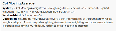

Maybe it's not necessary to create the auxiliary table?
Col Moving Average  provides some settings to compare values within a sliding window:
what are your next steps?
