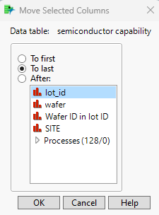

Not all options are grayed out, if you click on Move selected columns, you will get a window that will give you choices on moving the selected columns.

Hi - I'm trying to separate all of the character columns from the numeric columns, but currently they are all mixed together.  If I select each character column individually, I could then use the "Move selected columns" feature. However, since there are over 2000 columns, I was hoping there would be a faster way than selecting columns one by one.
