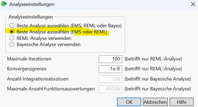

even though this chat is a few years old, I would like to reopen the topic. I am facing the same problem described in this chat. I now found out that minitab uses the EMS-Model to calculate the variance components for the GR&R. However, JMP automatically selects REML for the model. In the settings for the MSA I can only choose the option "Choose best analysis (EMS or REML)" and then JMP always choses REML. When do fit model and standard least squares, I get the same result for the variance components as in minitab (or "by hand" in Excel). I somehow have to get JMP to use the model I get from the standard least squares fitting for the GR&R.
Does anybody know how I can force JMP to use EMS in the MSA?

I attached mock data that describe the problem: I am looking for the same result as in Minitab, probably, the REML model that JMP uses is a better fit for the model, however due to company guidelines I need to stick to the EMS model for GR&R. Minitab uses the EMS model.
In my example (GR&R_TestData.jmp) I have a "classic" crossed GR&R design 5 parts, 3 operators, 2 trials. Minitab does the ANOVA using the EMS model and then calculates the variance components using standard GR&R formulas:

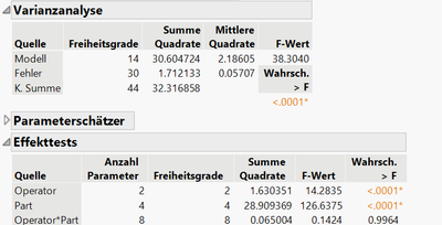

In JMP I get the same ANOVA table, when I use the EMS model in fit model:

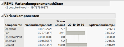

However, when I use the  Variability Chart for Gage R&R in JMP, JMP automatically uses the REML model, resulting in (slightly) different parameter estimates/variance components.
If jmp would use the MS values from the EMS model for the GR&R, I would get the same results as in Minitab. Thus, I need to force jmp, to use EMS instead of REML. However, in the analysis settings in the Variability Chart for Gage R&R in JMP I cannot choose EMS. JMP choses automatically.

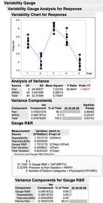

I used your data table to try and re-create your output for the Quality and Process> Measurement System Analysis>MSA Method>Gauge R&R then selecting Variance Components and I can't recreate your output? I do get the exact same ANOVA table.
 Often, if you can only get REML, it is because there are negative components using EMS method, but I can't tell if that is the case.
