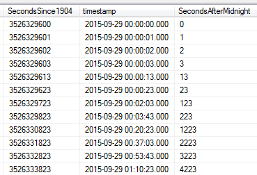

So far so good. No problem up to this point. The "SecondsAfter1904" are correctly transferred to the database and the timestamp is also calculated correctly. Have a look in the database:

Although conjecture, i think you are correct. It really seems like every second adds 1000 seconds. Also the reset is happening somewhere between 23 and 123 seconds. I could imagine, that the issue is that the datetime format in SQL features milli, micro and nanoseconds (dd.mm.yyyy hh:mm:ss.mmmmmmn). Continuing the speculation, it could be, that up on import from the database to JMP, JMP thinks that 1000 milliseconds is 1000 seconds instead of 1 second.

The formula applied in the database is actually not interacting with JMP at all. And the calculation is obviously correct, as can be inferred from the first picture. What is happening is, that an INTEGER is transferred to the database and the values of the INTEGER happens to be the elapsed seconds since the "JMP epoche" (seconds since 1904).
