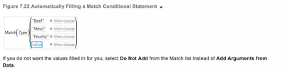

The JMP documentation states that when MATCH is chosen in the Formula Editor, you should get some kind of pop-up list that asks if you want to add the arguments from the data (see below). This would save me some time but unfortunately I don't see any list when I choose MATCH. Was this feature removed? Am I doing something wrong? Is this a computer specific feature (I'm using a Mac)?

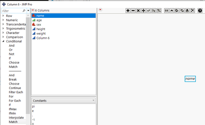

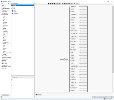

First add your column
Then find match and click on it once and select
And you should get
And you should get

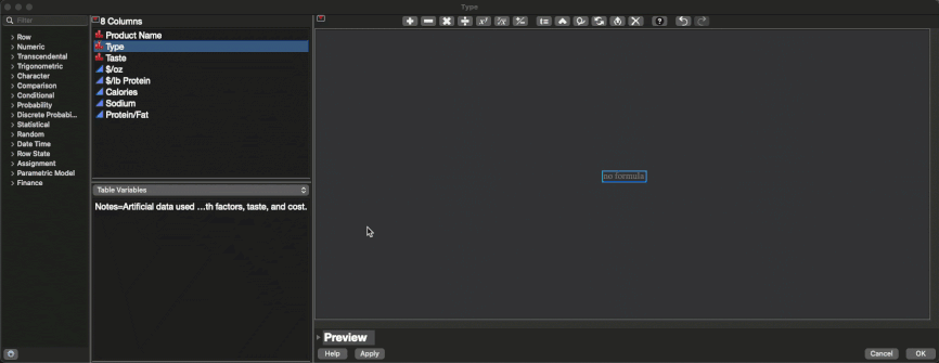

See attached video. I am using JMP 18.0.1 and using macOS Sonoma 14.5

You don't have the type column added to the formula editor. You have to have it added before you click on Match

As @jthi  said, you need to put your variable "Type" into the formula first, THEN select the MATCH function. Notice in Jeff's video that he has the variable entered into the formula before choosing MATCH.

Arrgh. I missed that. Sorry about that.
Thanks. I've got it now.
