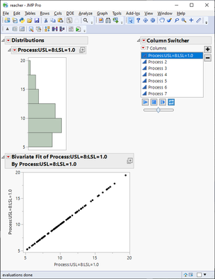

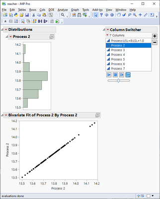

Re: column switcher linked multiple platform
Thanks for the note.
If the column name has special characters in the name, the expression does not work
Example columns: "Process:USL=8:LSL=1.0"
jthi
Which JMP version are you using?
Works fine for me (using JMP18.0.1)
View more...
Names Default To Here(1);
dt = Open("$SAMPLE_DATA/Process Measurements.jmp");
Column(dt, 1) << Set Name("Process:USL=8:LSL=1.0");
colnames = dt << getcolumnnames(numeric, string);
colnames = Filter Each({name}, colnames, !Is Missing(Regex(Lowercase(name), "^(process).*")));
Eval(
	Eval Expr(
		nw = New Window("reacher",
			H List Box(
				V List Box(
					dist = dt << Distribution(
						Continuous Distribution(
							Column(Eval(colnames[1])),
							Process Capability(0)
						Histograms Only
					biv = Bivariate(Y(Eval(colnames[1])), X(Eval(colnames[1])))
				cs = dt << Column Switcher(
					Expr(
						Name Expr(As Column(dt, colnames[1]))
					colnames
cs << Link Platform(dist);
cs << Link Platform(biv);
-Jarmo
