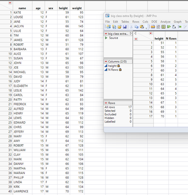

Summary Table (group by height):
So let's say I am on first row, the height is 59 and occurrences are 2, I want to populate that information in the current data table (dt) in a new column (height_qty).
