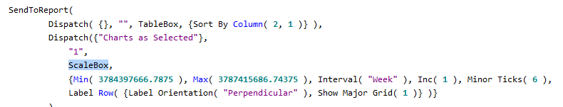

jthi
Re: Loop through "SendToReport" element in process screener
This part told me that I could (at least try) to use ScaleBox
You could have also used AxisBox (it might be that in earlier JMP versions you would have had to use axisbox). Note that it has different start index
