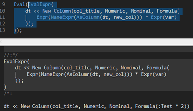

In more general, I would say that if you start replacing variable names by evaluating them to values, it might be a sometimes a good idea to evaluate all of them. What I mean by this in this case is that it might be beneficial to evaluate the column title also
This has for example additional benefit when you are debugging your code. Below is simple example of creating column from reference and with a variable which does work fine
Names Default To Here(1);
new_col = dt << New Column("Test", Numeric, Continuous, << Set Each Value(1));
col_title = (new_col << get name) || "* var";
var = 2;
Eval(EvalExpr(
dt << New Column(col_title, Numeric, Nominal, Formula(
Expr(NameExpr(AsColumn(dt, new_col))) * Expr(var)
but if you had some issues, you could just highlight the EvalExpr() and everything inside it and run that part of the script
col_title isn't evaluated (not a problem in this case BUT it could be in if you had more complicated script) and just by adding (in this case) one more Expr() you will get more information what is really going on
