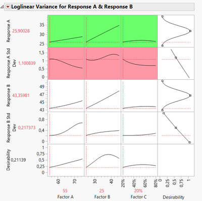

While using Loglinear Variance model, there is an inconsistency in the model for the Variance model. I put up an example below to explain the situation.
I build 2 models using Loglinear Variance:
Model 1 : Response A.  Factors A, B, C.
Model 2 : Response A , B. Factors A, B, C.
Note: Response A and Factor A,B,C are the same data for both Model 1 and 2.

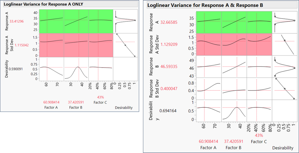

Comparing Model 1 to Model B , we focus on the Mean Model and Variance model for Response A.
The Mean Model for Response A is exactly the same between Model 1 vs Model 2 (the green background).
However, the Variance (or Stdev) model for Response A between Model 1 vs Model 2 (the red background) is totally different.
The comparison is also done with the same Factor settings and same scaling.
It seems that by just adding another response to the model (in this case we add Response B to the model with Response A) the Variance model become different. Response A and B are independent and should not affect each other.
Is this situation with Loglinear Variance considered normal and can be trusted?

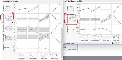

I tried to reproduce the situation you have with the JMP sample dataset InjectionMolding.jmp and creating a new response column and two models, one with response Shrinkage and one with Shrinkage and Shuffle[Shrinkage] responses, with the same terms in both models.
I see no differences in the profiler when creating a model with one or two responses, using Loglinear Variance :

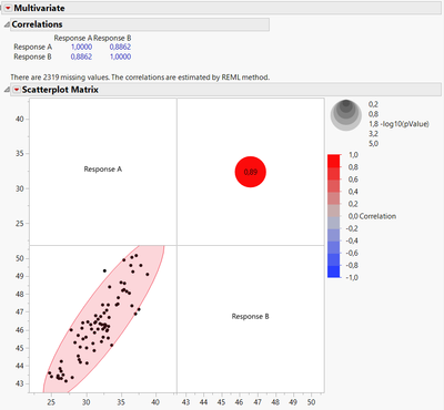

One preliminary remark : even if your responses may be individually measured, they are not rigourously independent, as a strong correlation can be seen between the two responses :

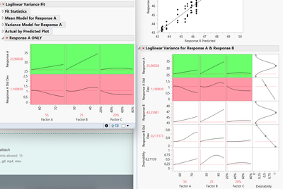

Here is the profiler with the two responses "as it is" (same as the one you showed previously) :

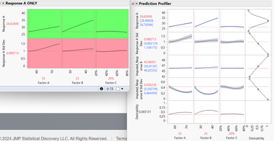

However, when doing automated data imputation technique on column "response B" to avoid missing values (and using this imputed response B as the second response), the profiler show better behaviour for response A and B (and profiler of response A is now identical to the profiler when the response A is the only response modelized) :
