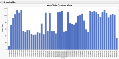

Attached is my data table. You can see that my dates in the x-axis in my chart is not in order. How do I write a script to sort the date column before I build the chart? Notice that my date column in the table is in char.

This is a common problem when you are new to JMP. Dates should be stored as a number. Numbers are right-justified in the data table. Your date column is stored as a character string, which you can tell because it is left-justified. JMP orders character strings alphabetically. I added a column to convert your date to numeric. Open up the column info on the new Date field so you can see how this conversion is made. It could have been done on the original date column, but I thought it would be harder for you to see.
