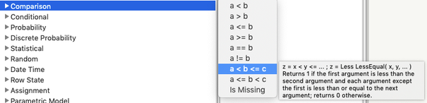

@txnelson gave you a working example but I can explain what you've got wrong in your attempts.
 If (0.50 < ( :Name( "P1-R1-D1-L1" ) > 2.0), "True", "False")
In this on you're trying a complex comparison that JMP doesn't support, namely a < b > c, i.e. a less than b greater than c.
Looking in the Formula Editor you can see the complex comparisons that JMP does offer, and that @txnelson used:
Notice the help text which gives a clue that JMP is a functional language and that these complex operators are really shorthand for the functions Less LessEqual() and LessEqual Less(). JMP doesn't have a function for the comparison you wanted to make.
