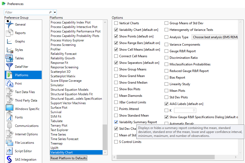

You can also set the Preferences for the Variability Chart Platform, so that the Variability Summary Chart will be displayed by default.  Go to
     File==>Preferences==>Platforms==>Variability Chart
And select the checkbox for Variability Summary Chart
