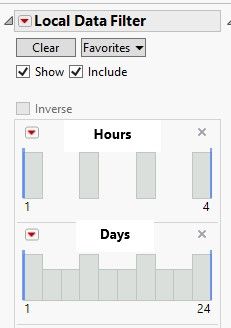

I have a script that when it runs by itself produces a Window with TAB boxes and appends several Graph Builder graphs to the different tabs.  All the Graph builder graphs have multiple local filters and they are displayed correctly.  As shown on this image.
However, when I run the same script as an included file on another script all the Local Data Filters are not displayed correctly.  One or two of the filters are usually changed to some sort of histogram that has two blue sliders that can be used to "select" a range of data. These "filters" do not have under the "red triangle" the usual five display options that Local Data Filters have.  As shown in this picture.
Is there a way to fix this?

Solved!
The column values have to be Nominal to generate the usual Local Data Filters (w/5 options).  Mine were Continuous hence the weird "blue" sliders.  I hope this note can be of help to the community.
