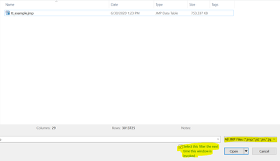

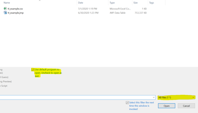

I have attached screen captures of the issue I face.
- Default file type filter is set to "All JMP Files" but I want default to be "All Files" so I can see CSVs.
- Changing the filter to "All Files" and then restarting JMP does not retain this modification.
- When opening a CSV the "Use default program to open..." checkbox is checked by default but I would like the default to be that text files open in JMP.
- Again, unchecking and then restarting JMP does not retain this modification.
