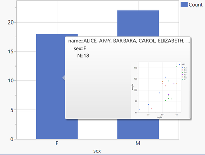

Application case:
If I generated a graph with a filter ( Bif Class plot restricted to age= 14)
Graph Builder(
	Variables( X( :height ), Y( :weight ), Overlay( :age ) ),
	Elements( Points( X, Y, Legend( 26 ) ) ),
	Local Data Filter(
		Add Filter( columns( :age ), Where( :age == 14 ), Display( :age, N Items( 6 ) ) )
and use it as a hover label (via "save Script" - "Hover Label"/"Paste Graphlet") ...
the local data filter is still there in the JSL script:

but it's function is automatically replaced by the local data filter from the Hover Label Extension Framework (all ages visible):
So, it would be great to have a "merge" function to combine the manual local data filter with the one from the Hover Label Extension Framework.

  1. If the Local Data Filter is created inside the Graph Builder part (my code), it's overwritten by the Local Data Filter from the Hover Label Extension Framework.
  2. If the Local Data Filter is created after the Graph Builder (your code), it overwrites the Local Data Filter from the Hover Label Extrension Framework. *)
*) Looking closer:
This just holds for the graph that opens after clicking on the miniature graph in the hover label.
The miniature graph itself still shows all ages, so case 1)
-> surprising that there are two distinct graphs generated. With different ways of overwriting the Local Data Filter?

Ah, "Add filter" adds a new "OR" group - I missed this detail:
So, we just need a solution to fix the miniature graph in the hover label.

That's a solution!
no chance for the Hover Label Extension Framework Local Data Filter handling to escape.
