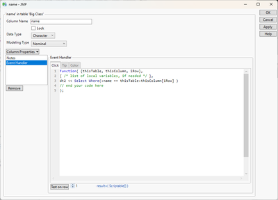

Hello - I don't think this exists, but thought I would ask anyway. I have a few different projects where I link columns. I have had a few times where I have thought that it would be super useful to be able to select the row of one of the linked tables, and then the corresponding rows in the other gets highlighted. I have one 50k row table and another 150k row table, and scrolling through can get tedious, as can trying to grab just those points. Of course there are row selection menus, but this takes a long time when you are switching your selection a few dozen times.
Is there a way to do this?
Thanks!

Event Handler can accomplish what you're describing.  Something like this:
For readability/copy/paste:
Function( {thisTable, thisColumn, iRow},
{ /* list of local variables, if needed */ },
dt2 << Select Where(:name == thisTable:thisColumn[iRow] )

This is awesome! Thank you so much!
I did notice that you can only do one row at a time. Is there a way to do an arbitrary selection of rows?
