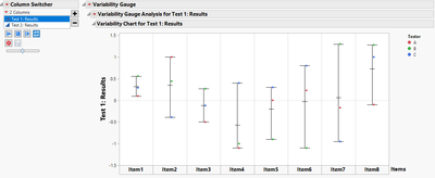

Hi All,
I have a script working perfectly on JMP16 which, among other things, plots a Variability Chart with Specific Dimensions and, most importantly, with a Row Legend.
I tried the same script in JMP17 and I encountered a problem that I cannot solve even manually.
The Var Chart is plotted correctly including the Column Switcher.
However, when another Y-variable is selected in the Column Switcher, the whole Var Chart is reset to pre-set Dimensions and loses the Row Legend.
This is an example of a manually built (no JSL) var chart from a very simple dataset.
If I select, "Test 2: Results", the following happens.
Has anyone encountered the same issue?
Is there a known solution?
Thanks in advance to any reply and have a nice day.

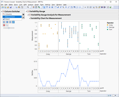

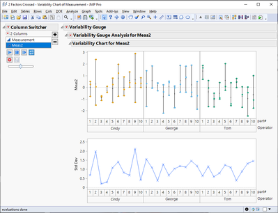

jthi
Re: Column Switcher in JMP17 Resetting Graph
Is your situation similar as this ?
Names Default To Here(1);
dt = Open("$SAMPLE_DATA/Variability Data/2 Factors Crossed.jmp");
dt << New Column("Meas2", Numeric, Continuous, <<Set Each Value(Random Normal(0, 1)));
var = dt << Variability Chart(
	Y(:Measurement),
	X(:Operator, :part#),
	Always use column properties(1),
	Column Switcher(:Measurement, {:Measurement, :Meas2}),
	SendToReport(
		Dispatch(
			{"Variability Gauge Analysis for Measurement", "Variability Chart for Measurement"},
			"Variability Chart",
			FrameBox,
			{Frame Size(514, 240), Row Legend(
				Operator,
				Color(1),
				Color Theme("Universal"(1)),
				Marker(0),
				Marker Theme(""),
				Continuous Scale(0),
				Reverse Scale(0),
				Excluded Rows(0)
		Dispatch(
			FrameBox(2),
			{Frame Size(514, 240)}
It does report that there is a problem
Cannot find item "Variability Gauge Analysis for Measurement" in outline context {"Variability Gauge Analysis for Measurement", "Variability Chart for Meas2"}
Hi,
Thank you very much for your reply!
Yes, it seems the same issue. Apologies for not attaching an example yesterday.

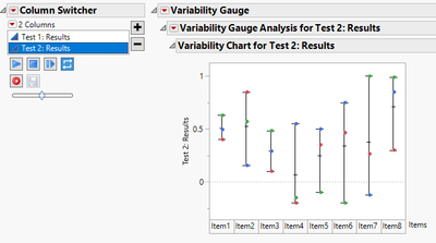

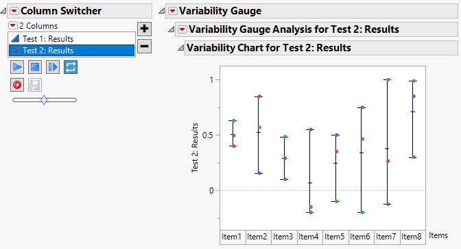

Is there a way to fix this?
