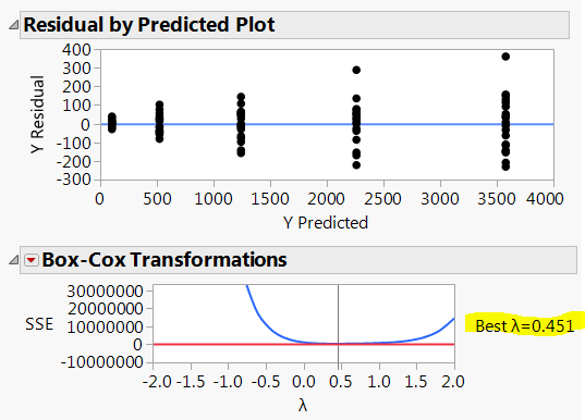

Sure.  So Box-Cox recommends some optimal transformation to make your variance more homogenous and the residuals more normal.  Basically, it evaluates the SSE for the model across a range of power transforms (y^λ), except the value λ = 0 indicates a natural log transform.  The transform that minimizes the SSE is the "best" transform.  However, bottom of the curve is usually kinda flat, so you can choose various transformations within a neighborhood. You usually want to pick one that corresponds to something meaningful.  For example, if Best λ = -0.98, I would choose to take the inverse because -0.98 is really close to -1.
Here's an example: I generated a linear model using normal errors and squared all the response values.  I should expect Box-Cox to tell me I need to take the square root to have normal data again.  Here's what I actually got:BoxCox.PNGBoxCox.PNG
 You can see that the "best" transform is 0.451, but I know the real answer is 0.5 and this is really close.  If I didn't know the real answer, I would still choose 0.5.  You can re-run your model with your desired transform by clicking the red-arrow next to "Box-Cox Transformations" and selecting "Replace with Transform."  You'll get a pop-up box that asks you to type in the value you want.  Press OK and you'll get a new Fit Model with the transformed response.
-- Cameron Willden
