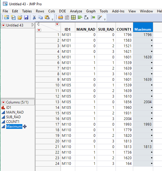

I think this might be what you want.  I used a formula to do the calculation, but if what I did is correct, there are several other ways to do it.
If( Lag( :ID1 ) == :ID1 & Lag( :MAIN_RAD ) == :MAIN_RAD,
	Col Max( :COUNT1, :ID1, :MAIN_RAD )
Jim

Thanks Jim. That works too! It will be great if I can get something like table below meaning the max value in col Maximun is in the same row as column Count1 max value.
ID1MAIN_RADSUB_RADCOUNT1Maximum
M1010017961796
M101011583
M101021521
M101031621
M101101601
M101111539
M1011216391639
M101131610
M105001601
M105011539
M1050216391639
M105031610
M105101856
M105111960
M105121931
M1051320042004
M1100019931993
M110011779
M110021820
M110031813
M1101018131813
M110111736
M110121620
M110131643
BTW, I will be interested to know what will be the several ways to do it :)
Thanks. Appreciate that.
