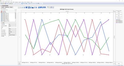

Line graph Y axis is wrong

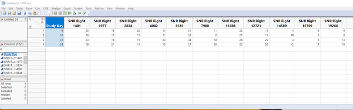

I'm trying to create a simple line graph and the y-axis is wrong. I've tried manually changing the y axis to span from -5 to 45 but it compresses the data within the lower portion of the screen. Please help.
Study DaySNR Right 1401 SNR Right 1977 SNR Right 2834 SNR Right 4002 SNR Right 5636 SNR Right 7988 SNR Right 11288 SNR Right 12721 SNR Right 14589 SNR Right 16769 SNR Right 19260
-423162014311122194199
312615151133027151038
4123161923341028203513
551921141527202526-21718

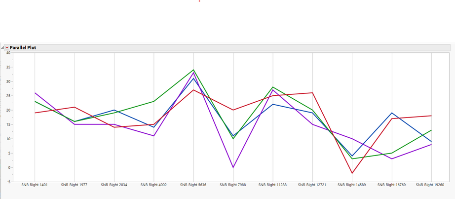

Re: Line graph Y axis is wrong
Using your provided data table, and
     Graph=>Parallel Plot
I get the following graph, which allows for the changing of the Y axis.  Also, I have specified to Scale Uniformly
Here is the script

txnelson
Is this the graph????
Jim

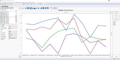

perrydl
Level I
Thank you for trying to assist me. I'm graphing raw data. The top is what I'm seeing and the bottom is what I need (and what JMP is producing from the same data type). The SNR frequency data should be on the X-axis and timepoints across. The data is from a single individual. I tried to change the Y axis limits but it only compresses the data.

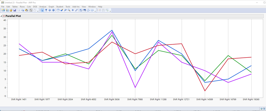

txnelson

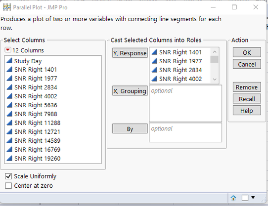

Here is the script
Parallel Plot(
	Scale Uniformly( 1 ),
	Center at zero( 0 ),
	Y(
		:SNR Right 1401, :SNR Right 1977, :SNR Right 2834, :SNR Right 4002,
		:SNR Right 5636, :SNR Right 7988, :SNR Right 11288, :SNR Right 12721,
		:SNR Right 14589, :SNR Right 16769, :SNR Right 19260
	SendToReport(
		Dispatch(
			"1",
			ScaleBox,
			{Min( 0 ), Max( 11 ), Inc( 0.5 ), Minor Ticks( 0 )}
		Dispatch(
			"2",
			ScaleBox,
			{Min( -6.01186672653397 ), Max( 40.6968191294088 ), Inc( 5 ),
			Minor Ticks( 1 )}
		Dispatch(
			"Parallel Coord",
			FrameBox,
			{Frame Size( 1525, 470 ), Marker Size( 4 ),
			Marker Drawing Mode( "Normal" ),
			DispatchSeg( PolylineSeg( 1 ), {Line Width( 3 )} )}
Jim
perrydl
Level I
Hi Jim,
That is correct but I don't know how to replicate what you did to generate the plot.

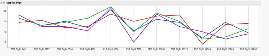

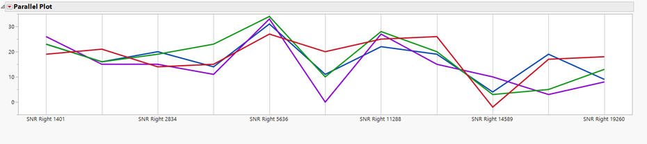

txnelson
I started with your data table
I then when to
I selected all of the SNR columns as the Y, Response columns and then selected    Scale Uniformly
Then the remainder is just changing the line color and thickness, and adjusting the X and Y axes
To change the line colors, click directly on one of the lines.  Then right click and select Row Colors and choose the color for the line.  Repeat for each line
To change the line width, right click on the graph and select Customize
Select Polyline, and change the line width

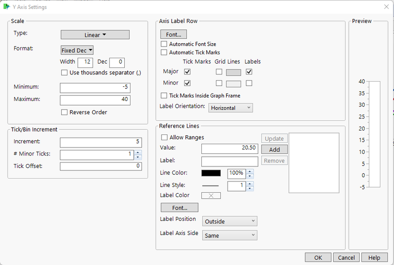

Not all SNR values are being displayed.  To change the X axis, right click on the axes and select Axis Settings
Change the Tick/Bin Increment to .5
Lastly, the Y axis settings can be changed using the same method as the X axis.  Right click on the axis, and select Axis Settings.
Change the Minimum and Maximum values to -5 and 40.
Change the Tick/Bin Increment to 5

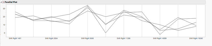

Which ends up giving the following graph
Jim
perrydl
Level I
This was an amazing help!  I just completed the graphs!  Thank you so very much!  I cannot tell you how much I appreciate your help.
