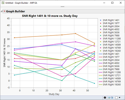

I'm trying to create a simple line graph and the y-axis is wrong. I've tried manually changing the y axis to span from -5 to 45 but it compresses the data within the lower portion of the screen. Please help.

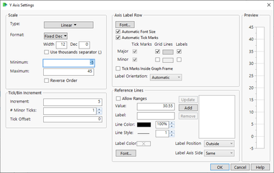

Can you post a picture of how the graph is incorrect?  If you double-click on the Y axis you can set the min, max and increment.
I was able to reproduce Jim's version of the graph very easily.

Thank you for trying to assist me. I'm graphing raw data. The top is what I'm seeing and the bottom is what I need (and what JMP is producing from the same data type). The SNR frequency data should be on the X-axis and timepoints across. The data is from a single individual. I tried to change the Y axis limits but it only compresses the data.

I started with your data table
I then when to
     Graph=>Parallel Plot
I selected all of the SNR columns as the Y, Response columns and then selected    Scale Uniformly
Then the remainder is just changing the line color and thickness, and adjusting the X and Y axes
To change the line colors, click directly on one of the lines.  Then right click and select Row Colors and choose the color for the line.  Repeat for each line
To change the line width, right click on the graph and select Customize
Select Polyline, and change the line width
Not all SNR values are being displayed.  To change the X axis, right click on the axes and select Axis Settings
Change the Tick/Bin Increment to .5
Lastly, the Y axis settings can be changed using the same method as the X axis.  Right click on the axis, and select Axis Settings.
Change the Minimum and Maximum values to -5 and 40.
Change the Tick/Bin Increment to 5
