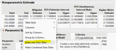

To do that, right click in the table and choose "Make into Data Table":
The generated table looks like this:

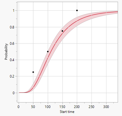

Then using Graph Build to produce a scatter plot, with Start on x-axis, and KME on y-axis. Then right click in the graph and copy the content:
Then paste to any place that you need, e.g. back into Life Distribution:
And turn off all other Nonparametric related plot options, and you get this:
